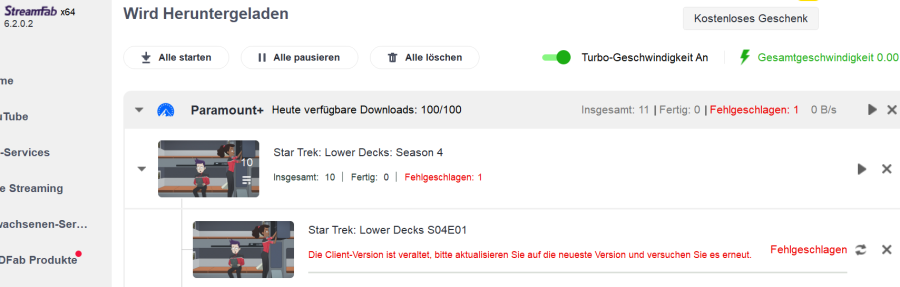

    With version 6.2.0.2, downloads on Joyn no longer work. You get an error message saying that the client is outdated and needs to be updated. However, with version 6.2.0.1, I can still download everything normally.
    Something seems to have broken with version 6.2.0.2 on Joyn.

    It is also on RTL+
    I think it is server-side, yesterday it worked
      I can only confirm (at least for joyn) 6202 release + beta affected
      not only new releases - same with older releases
      [Info]: **** Get download Processed fail. The error is : 309
      but 6201 works fine​

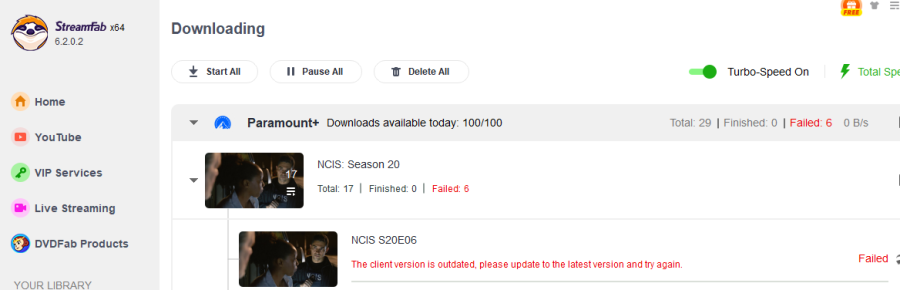

        It's the same problem with Paramount+ (Deutschland) ...

              Originally posted by Brozilla View Post
              I mean paramount+ isnt a only german thing
              And with v6.2.0.1 it seems everything works
              Okay, i meant client requests from Germany
                I can test with a vpn tomorrow but i guess the problem is the same
                  Same error with P+ US Account and connected via NYC
                  Click image for larger version  Name:	p+_error.jpg Views:	0 Size:	67.4 KB ID:	452388
                  edit:
                  @dalemccl
                  > I'm getting this with Paramount+ in U.S.​
                  with 6202 ?
                      I did notice when going to 6202 that they changed the browser. It looks more like Chrome than it ever did before. I even get the "save password" popup like Chrome does when logging into sites.
