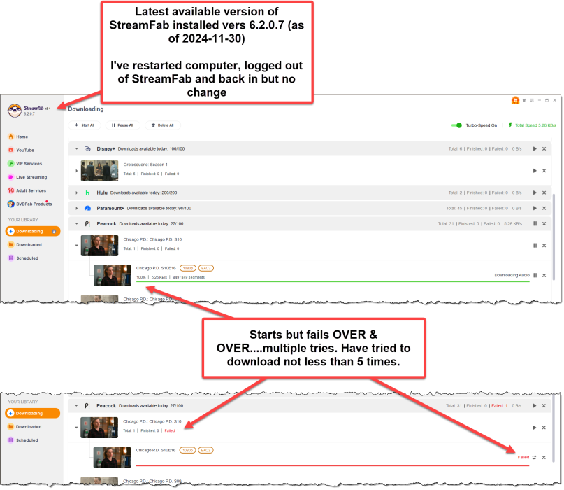

    I'm experiencing issues with StreamFab (version 6.2.0.7 as of November 30, 2024) while attempting to download certain episodes of Chicago Fire, Chicago P.D., and Chicago Med from Peacock.
    The issue I'm facing is that after the download seemingly completes (reaching 100% progress), it then fails immediately afterward. As shown in the attached screenshot, it clearly shows the progress at "100% complete" before changing to indicate that the download "Failed." I've tried downloading "Chicago P.D." Season 10, Episode 16 multiple times (at least 5 attempts), but each time it ends with this failure.
    Here’s what I’ve done so far to try to resolve this:
    • Restarted my computer between download attempts.
    • Logged out and back into StreamFab.
    • Logged out of my Peacock account and logged back in.
    Despite these steps, I still encounter the same issue. Some episodes do download successfully, but others, including the specific one mentioned above, keep failing.
    Any assistance would be greatly appreciated!
    Attached: Screenshot showing download failure at 100% completion for Chicago P.D. S10E16.

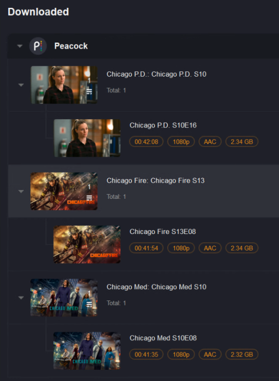

          As you can see, I didn't have a speck of trouble with the three Chicago's including your troublesome Chicago PD S10E16.
Name:	Screenshot 2024-12-01 2.30.39 PM.png
