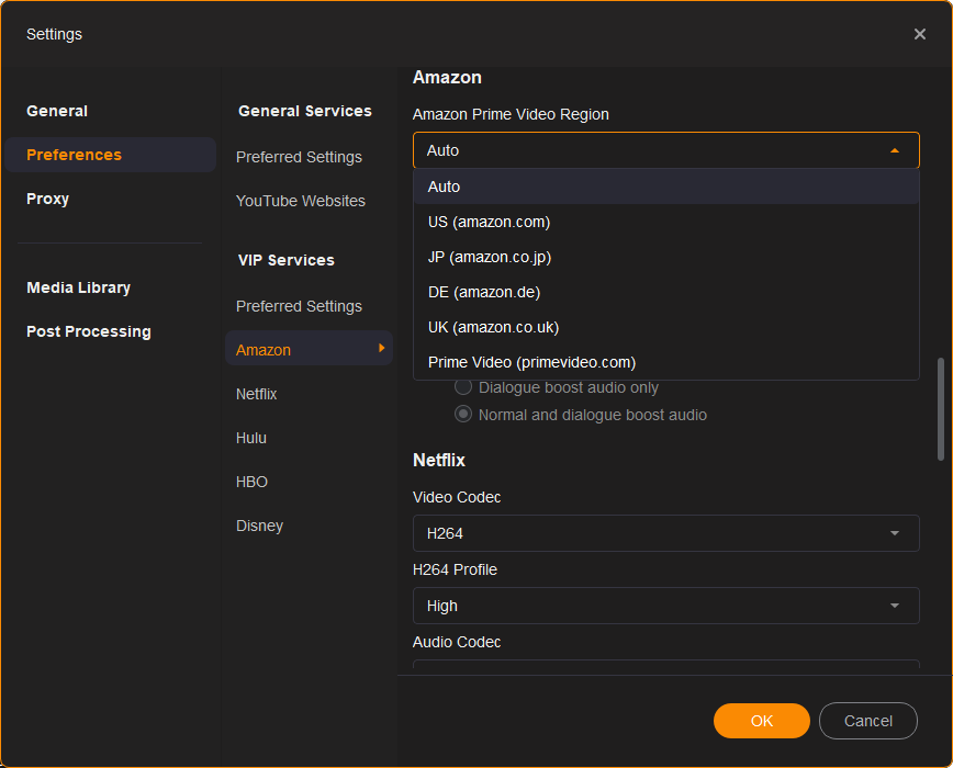

        No, don't need the VPN connection, please set the Amazon region to "primevideo.com" in StreamFab Common Settings and try it again.

          And by "try it again", you may have to restart StreamFab and/or your computer.
            Thanks, it works.
