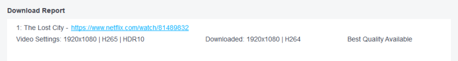

    The below Screen Shot shows what SF says using MAIN and selecting H265 - HDR10
    REALLY weird, I did not get that message using the HIGH profile.
    So it does not look like it's you, as I got these results. There are no other settings I am aware of.

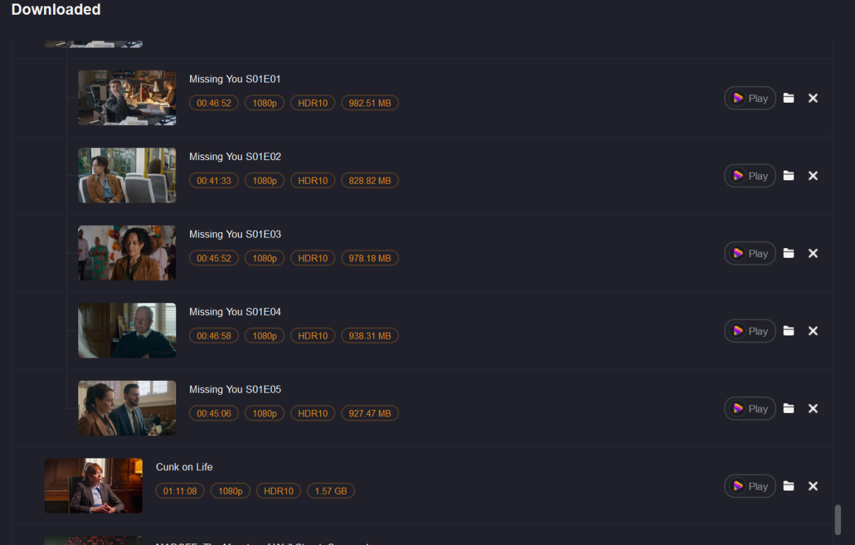

            The next thing to consider is that at some point, a Movie or TV Show made by Netflix will no longer be available in H265. Take the very good German TV Show Dark. I downloaded it in H265 HDR a couple of years ago but if i try now, only H264 is available. That is why i download new Made by Netflix stuff right away to ensure i will get the H265 HDR version. See my downloaded list:
