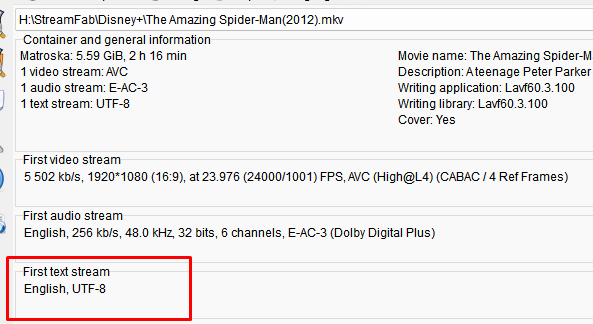

            ADDED: I got the srt/cc for amazing Spider-Man. This is using the latest 6228.
            Click image for larger version  Name:	dTFVZ09NRdGxYs2MuKsBaw.png Views:	0 Size:	21.9 KB ID:	461481
