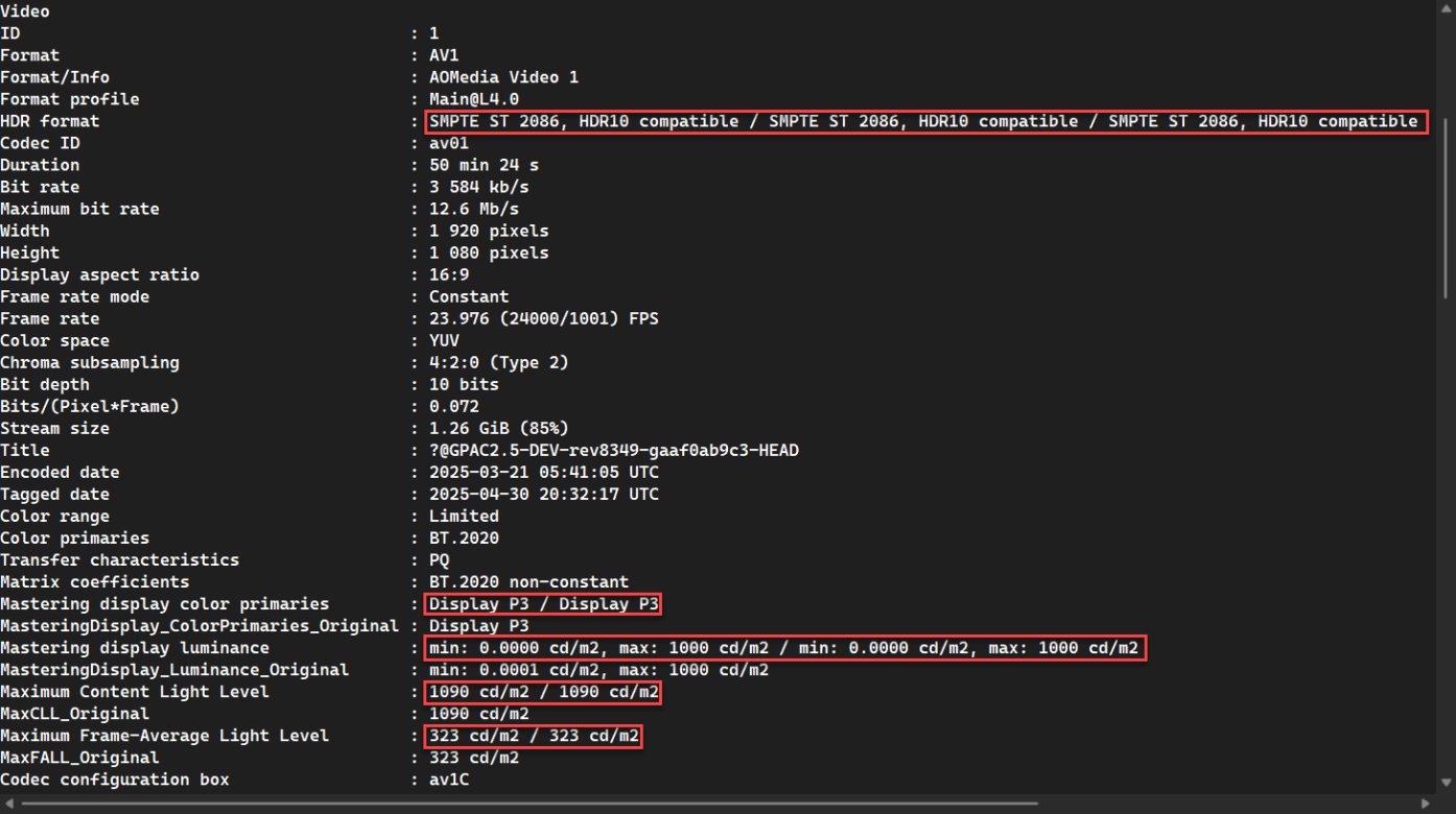

    For MP4, it does work, although the metadata for HDR is in triplicate, and other meta is in duplicate:
    Click image for larger version  Name:	image.png Views:	0 Size:	294.2 KB ID:	462461
    If i use MP4, the resulting file has HDR10 metadata but Kodi cannot play the file. MPC-HC does play the file. The extra metadata might be why Kodi fails as it does support HDR10 is trying to play it correctly while MPC-HC does tone mapping...

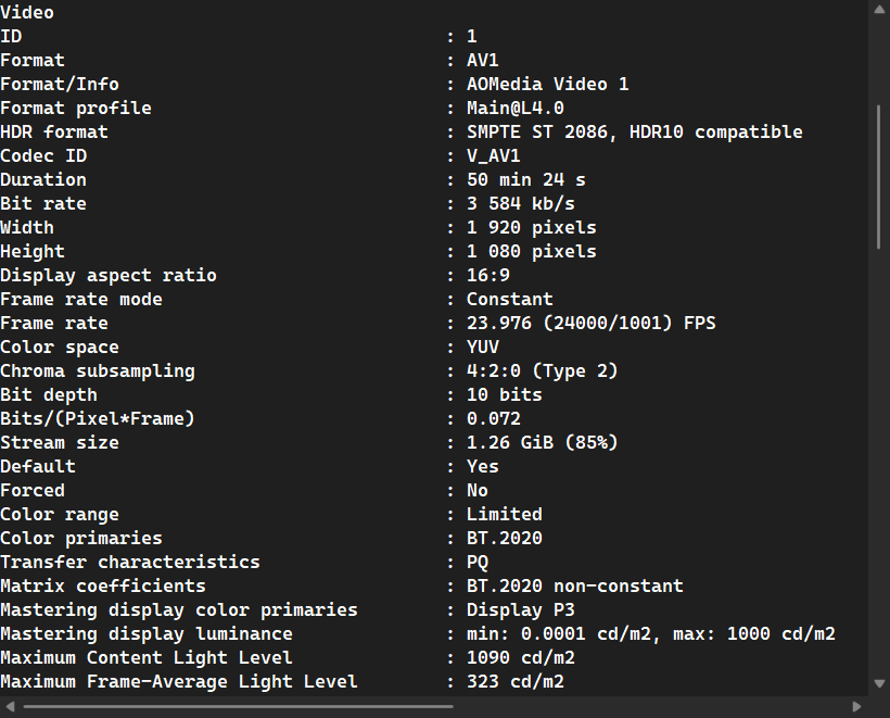

    If i use MKVToolnix 92 to remux the StreamFab mp4 to mkv, the resulting file is HDR10 and it has proper metadata:
    Click image for larger version  Name:	image.png Views:	0 Size:	58.5 KB ID:	462462
    If i then take the mkvtoolnix file and use ffmpeg to remux back into an mp4, the metadata is fixed and it plays in Kodi

    I get the same (Original + changed) values with mp4 created by mp4box:
    Track name + Performer (?) = epi title
    Code:
    HDR format : SMPTE ST 2086, HDR10 compatible / SMPTE ST 2086, HDR10 compatible / SMPTE ST 2086, HDR10 compatible
    MasteringDisplayColorPrimaries_Original + MasteringDisplay_Luminance_Original + MaxCLL_Original + MaxFALL_Original
    with mkv (ffmpeg) I get error 702 "Invalid Mastering Display Color Volume box" (ffmpeg 6.0)
    with mkv (mkvtoolnix) all fine and correct entries (mkvmerge v68)
    After replace ffmpeg with 7.1.1 error 702 is away
    and like mp4box (but without MasteringDisplayColorPrimaries_Original)
    and new => VENDOR_ID : [0][0][0][0]
    With my standard player mpc-hc it is only slightly darker ..
    .. but I think mkvmerge should be the best choice for Kodi at the moment
