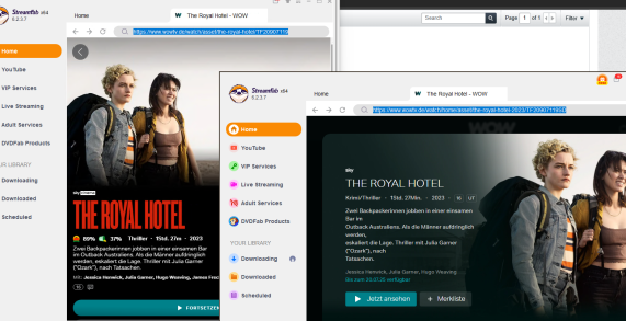

                obviously there are two different web site designes rolling out also having different links to the same movie. One PC goes to:
                https://www.wowtv.de/watch/home/asse...3/TF20907119SD - which is not downloadable
                the other
                https://www.wowtv.de/watch/asset/the...tel/TF20907119 - old style and downloadable

                  I read they'll be using NBC Peacock's streaming technology in the future. It's possible that the module needs a major fix.
                    It would be normal for SF not to support
                    two different websites with same VIP Service
                    Works fine for me:
                    Redirect me to Homepage
                    Perhaps it's an A/B Testing (split test; currently not the same for all)
                    I know only that all tested titles works fine for me ..
                    .. and last week Tuesday (May 13) the Homescreen/all sites was blank for multiple hours​​
