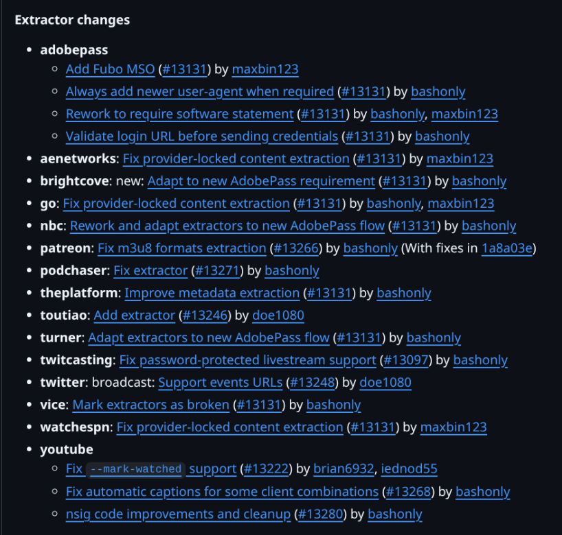

              You are correct. The latest yt-dlp is very heavy on AdobePass fixes. This is from the latest yt-dlp nightly (5/28) -
Name:	Screenshot 2025-05-29 7.24.07 AM.png
              The Turner fix should handle the TNT problem.

                        In theory, the latest nightly yt-dlp should fix the AdobePass problems with all the Turner channels (TBS, TNT, TCM, and TruTV) and NBC channels (Bravo, Oxygen, CNBC, MSNBC, NBC, Syfy, Telemundo, Universo, and USA). It also adds Fubo to its MSO list.
                        TCM and Telemundo, I believe, are the two oldest channels that SF had AdobePass problems with. If my message search function was working, I would have posted a link to the messages about them. It's got to be two or three years now.
