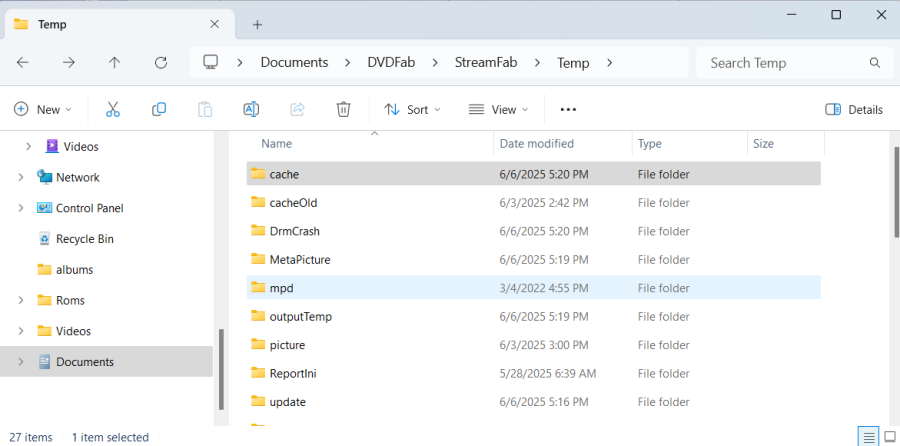

                    I did this to try and correct AppleTV logging me out when trying to download. This problem did not go away Click image for larger version
Name:	Screenshot 2025-06-06 172750.png
