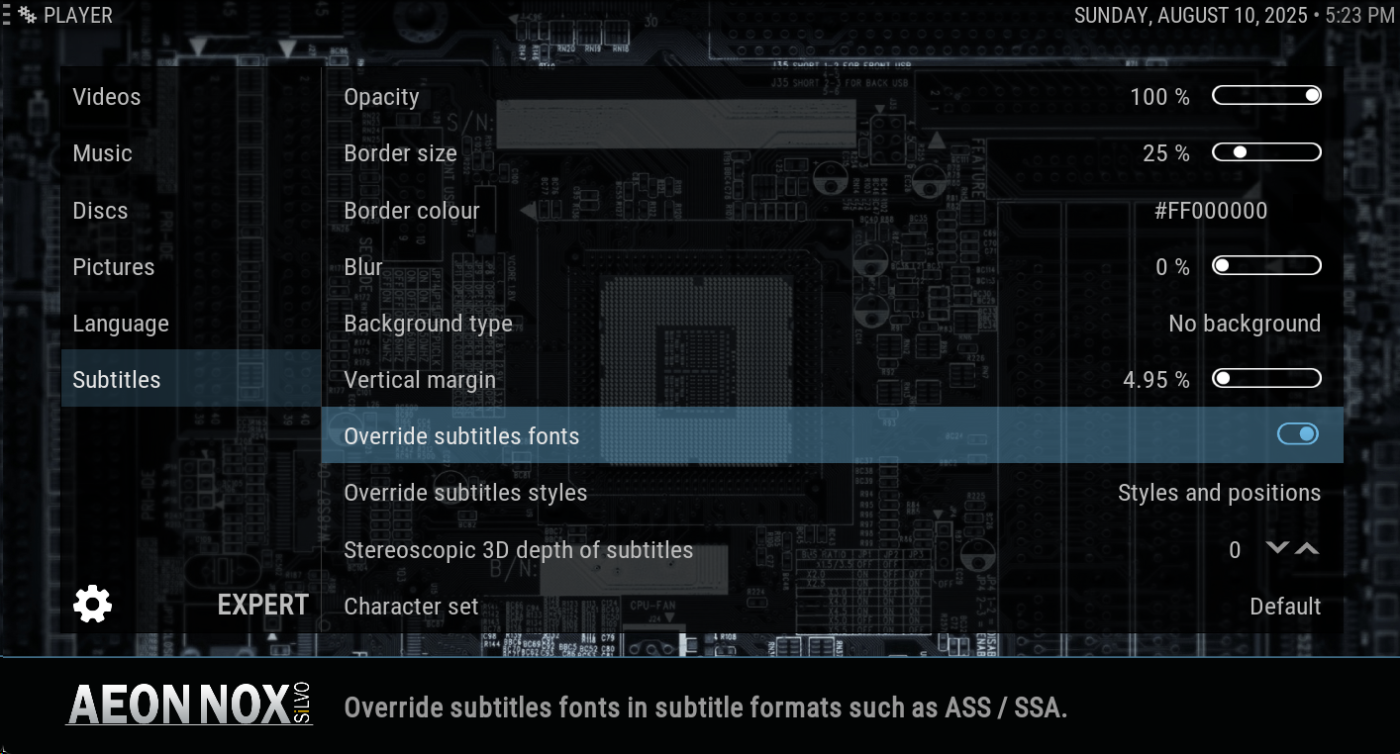

                          I personally prefer plain text subs. No positioning or styling. As a matter of fact, in my Kodi settings, i tell it to disable all styling and positioning for all subs.
