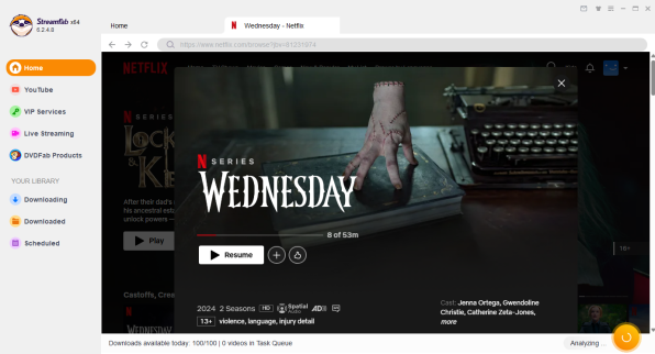

    Hey,
    everything worked well until today... If I want to DL sometnhing from NF (in this case I tried 3 movies/seasons, logs are from Wednesday that I downloaded previously without a problem), just a window with analysing URL will pop for few seconds and then only "Analyzing button" withn rolling circle is displayed... No other action is performed... Sernding logs and DRMCrash file.
    Click image for larger version  Name:	image.png Views:	1 Size:	149.1 KB ID:	466798
    I can't embed files (they're disappearing from post) so link to WT: https://we.tl/t-D3Hq0WRQlz​
    DDeleted the cache, clean reinstall, etc but nothing helps... So I think that there are some changes at the NF end.
