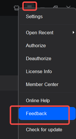

                Please submit the log file using the Feedback feature in DVDFab13.
