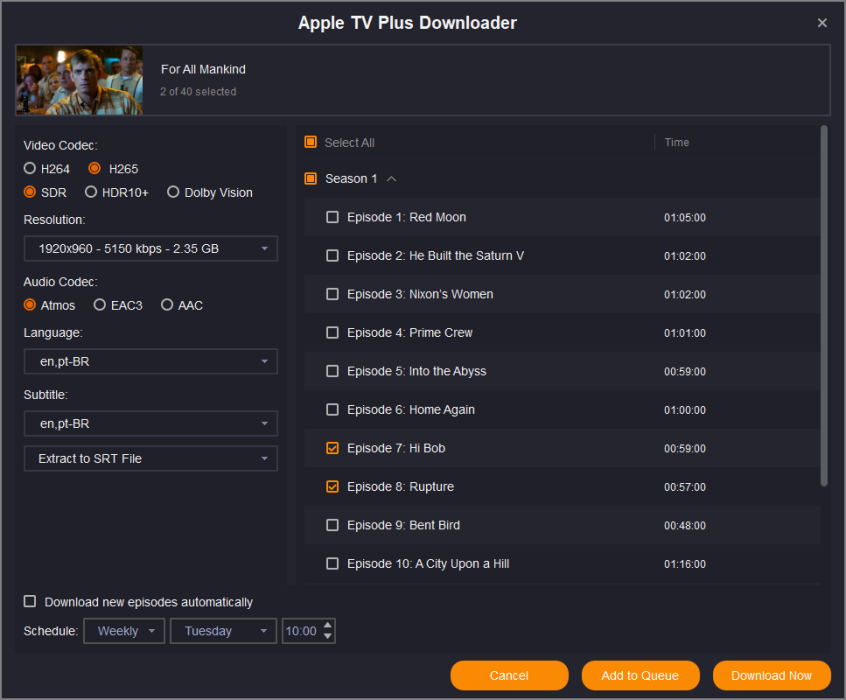

The error rate increases if you select several audios and/or several subtitles.

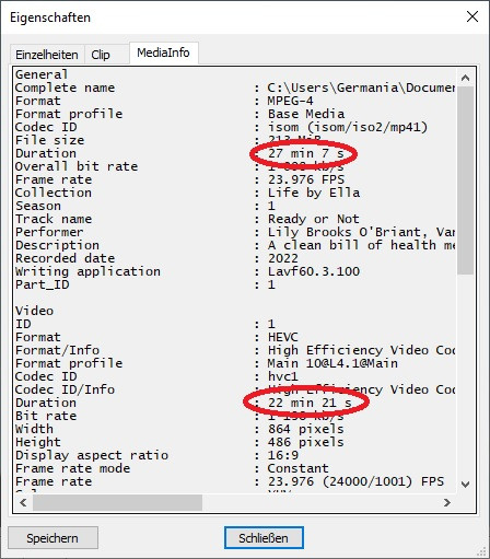

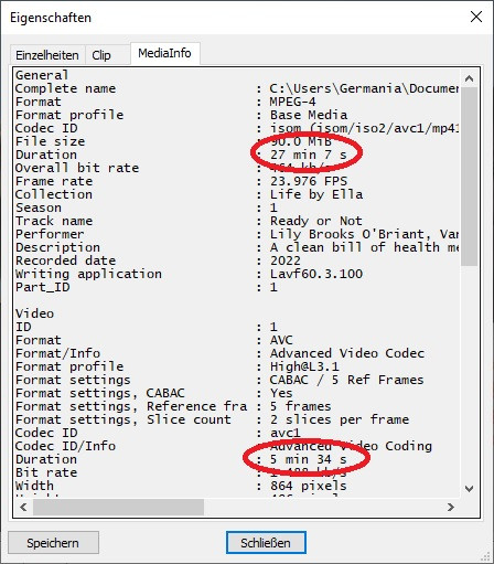

I tried "Life by Ella.s01e01" (only sd) with german AAC + forced subs
and have 5x [Critical] in StreamFab.log for subs (1 missing segment - 4 retries)
and 5x [Critical] for video (1 missing segment - 4 retries), audio without errors
The missing video segment is 39 - video freeze at 05:34
2nd try without subs and the same video segment 39 is missing
3rd try with H265 SDR and now missing segment 159 - video freeze at 22:21
Can you search for [Critical] in StreamFab.log whether the errors are in the same segments?
