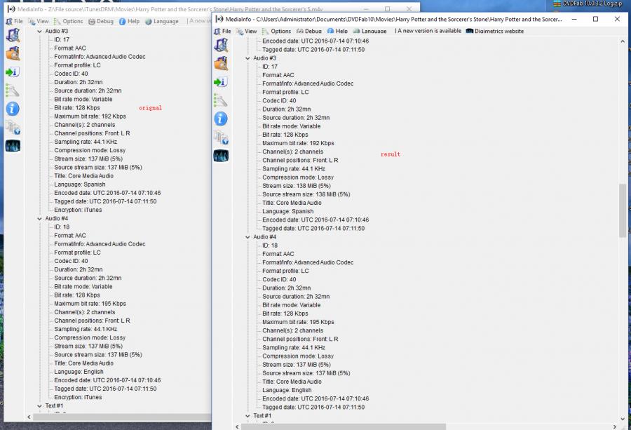

I have rented a movie that I previously bought a while back when Requiem still worked. The size of files with the drm removed differed quite alot, so I did what I've allways do with iTunes movies, scrubbed the metadata with ffmpeg and demuxed the files.
The movie and AC3 track is identical, did a byte compare with UltraCompare and they are identical, however the AAC track in the file that been processed by DVDFab was 25 000 kB smaller than the aac track processed by requiem.
Only reason for this is that the aac track have been reencoded (yes, the process speed with DVDFab feels that its slower than Requiem so this is probably the reason.)
I don't want to hear an excuse that the aac have addition metadata in it that needs to be removed, because that I have checked earlier also by buying the same movie from 2 different iTunes markets with 2 different accounts and they match up exactly the same.
Any comments from DVDFab on this?
