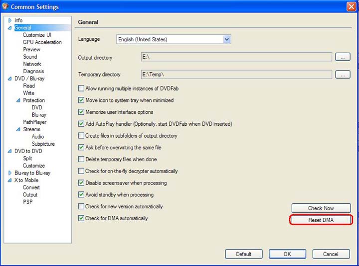

To reset DMA in Fab, go to
Common Settings > General
click on the Reset DMA tab
For particularly stubborn DMA reset issues, you can try running the VBS Script File found
here
here
