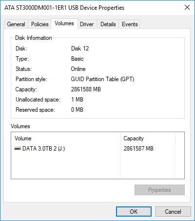

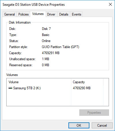

    I've uploaded screen prints of the volume information for a 3TB Seagate drive in an Orico USB SATA caddy which is recognised and works perfectly in the Movie Server, and the same information for a 5TB Maxtor USB drive that is not recognised at all by the MS. As you can see, the partition / volume information is identical for both (other than the size). Both volumes have a single partition that Windows disk manager shows as "Healthy (Primary Partition)".

    I did think this might be a GUID vs MBR issue, but of course the 3TB drive in the SATA caddy (that does work) also has to be a GUID partition because it's larger than 2TB.
