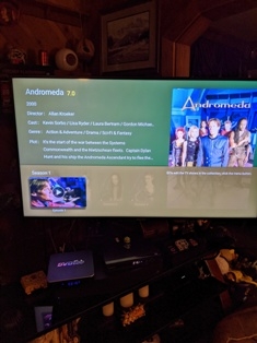

        This is what I'm talking about. There are 6 discs to season one of Andromeda. Only allows one to be played from poster wall. Does this with every tv show I have on the server.
