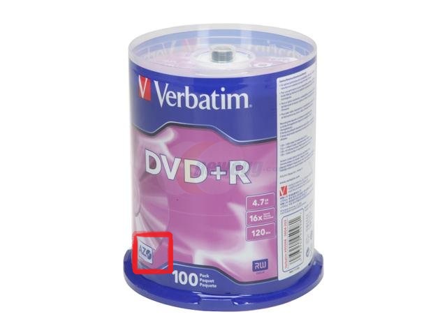

            Whether you use +/- R blanks always look for the AZO label on the packaging. If you buy the DataLife series Verbatims with the white label you might be getting anything from anywhere.
