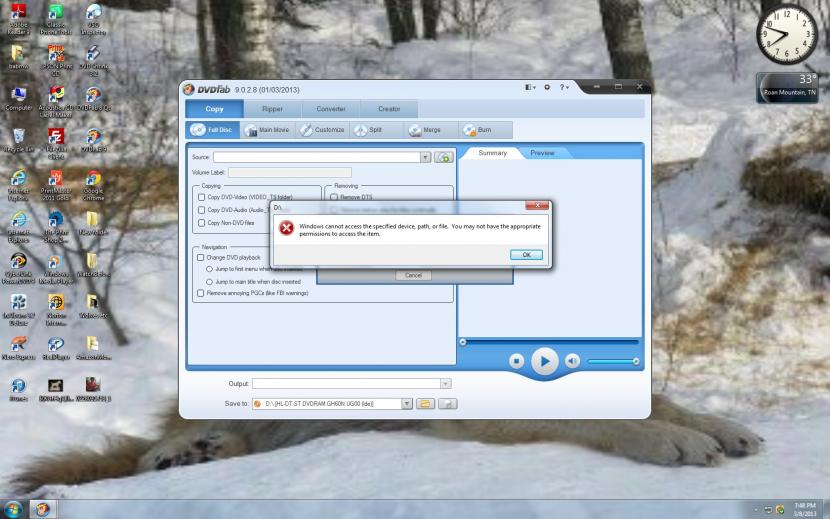

    I just updated my DVDFab 9.26 to the 9.28 I think it is, and everytime I open the program up this is what I get.What is this error message about and why am I getting it?
    Mine does that too, I just click ok and ignore it. It doesn't seem to hurt anything.

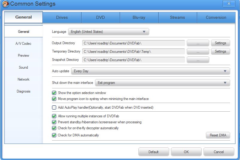

              you have to go in to common settings and uncheck add auto play handler I found that out I got the same error & every time I change the windows default and started up the dvdfab I would get that same thing. just don't check that and it will stop it from popping up

                            Thanks everyone I went in to common and unchecked the box for autoplay so will see if that helps. Thank you all you guys are awesome I always know I can come in here and ask for help and everyone is so great with lending a helping hand. I appreciate it.

                              The autoplay box is checked during the install process. Once you uncheck the box and reset your win autoplay for DVDs and Blu-Rays, it will not happen again. I assume they will not check the box by default in the next release as I'm sure the Devs are well aware of the issue...
