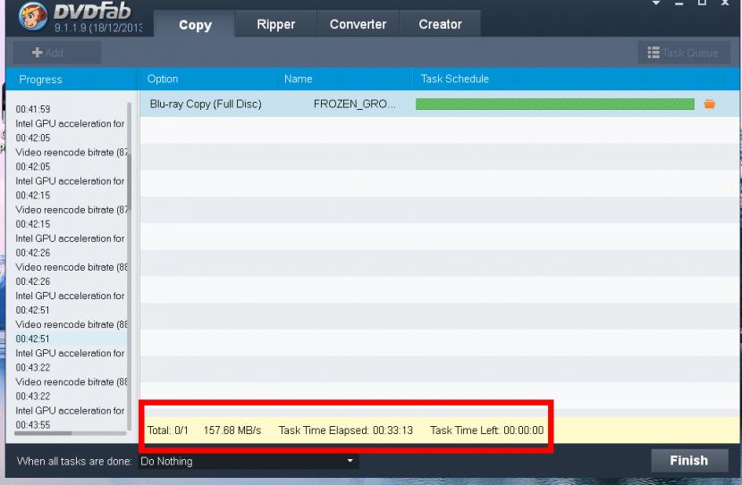

    90312: Did my first speed test using Quick sync with a regular blu ray I used Frozen ground as it's a larger blu ray 45.4 gigs.
    This test combines lightning shrink with Quick sync.The processor is ivy bridge
    I7-3770 3.40ghz with 8 gig hi performance memory pc 17000 2133mhz data rate.The computer has 4 cores and 4 virtual cores so Fab see's and uses all 8 cores.
    I Ripped Frozen ground 45.4 gigs using Fab full disk from from blu ray disk to hard drive in 32.11 minutes 33.51 mb/s.
    I then took the movie from hard drive and put in Fab to compress the full disk to 25 gigs.The box in Fab telling you frames per second on my old computer now changes to MB/S.Fab starts off slow 14.76 MB/S then slowly increase's to 35.84 MB/S with Cpu usage only 9-14% AVG.Memory used 3.20GB-3.43GB
    Convert time is 33 mins.13 seconds

    My only question is why the CPU only runs Fab at 9-14% avg.during compression of a movie and mostly used only part of 4 cores the other 4 cores were running but tiny amounts of usage show up on the chart for running live cpu,memory tests.I do show 8 cores in Fab and have max set for memory fast speed normal quality.
    90312 Anyway it's because you posted your computers speed with Fab that I knew right their and then I had to have a new toy thanks to you after a 2 day set up I am getting into more testing now.A side by side 3d should be really fast also that's next on my test list if anyone wants to know the results of that test speak up and I will post it here.
    Glenns, the Intel HD 4000's Graphics Processing Unit is doing the lion's share of the work when using Quick Sync so the Central Processing Unit is not left with much to do. Since video is all the GPU does, it does it much faster than the CPU.
    By comparison your speeds are impressive, glad you're not disappointed since I'm the reason you got it, that could have been bad!
