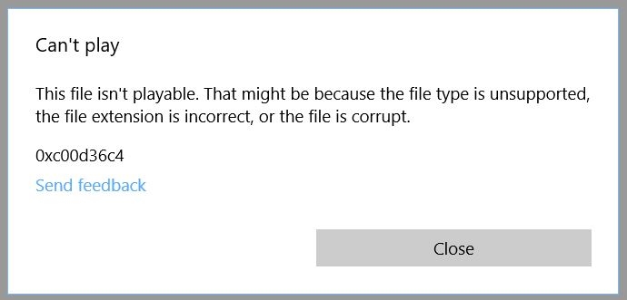

    I have ripped 2 separate Blu-ray discs with the latest version using the same settings I have been using forever and the output file is not being recognized.
    I double click it and get the attached message.
    Discs ripped are Spider-Man: Homecoming and Pirates of the Caribbean: Dead Men Tell No Tales.

    I have been getting the same issue. The output files are not even close to the size that I have set up in my custom settings. I try to play them on my computer and cannot. This just started just recently with the new version.
      It appears to be a CUDA issue. I turned off CUDA and used software and the resulting file works.
