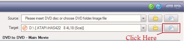

      Hi 89stang_gt
      You will select this folder icon see pick
      CBR929
        Ok the WDTV Live can play theVOB from the folder just fine. not sure how to set it up as I not have one at the moment but do plan to get one soon for the bedroom. Might be a good idea to go to their community forum to ask. You cana s well save as ISO instead or use the DVDFab DVD Ripper and convert to a different file format or use the VOB Passthrough to make one large VOB
