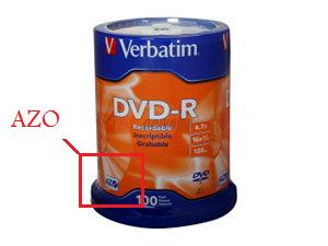

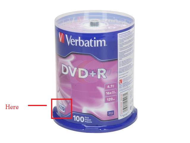

        The media I suspect may be the culprit, recommend switching to Verbatim with the AZO dye on the package.

            Remember to only get Verbatim discs that have the AZO dye on the package label.
            See pics
