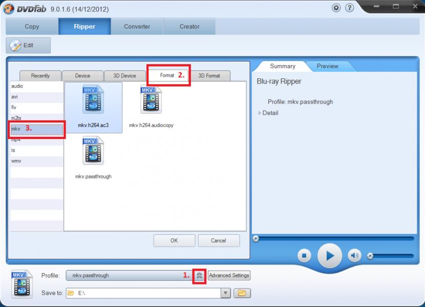

              If you are having trouble finding it, after selecting the source I have made a screen shot and numbered the sequence of button pushes that should get you there:
                As you were typing, I was digging. I found exactly what you just excellently described. I will try the passthrough method. What size files do you typically get? I know the sizes vary greatly, but I'm curious as to how much larger a passthrough file is compared to the MKV.h264.audiocopy method.
