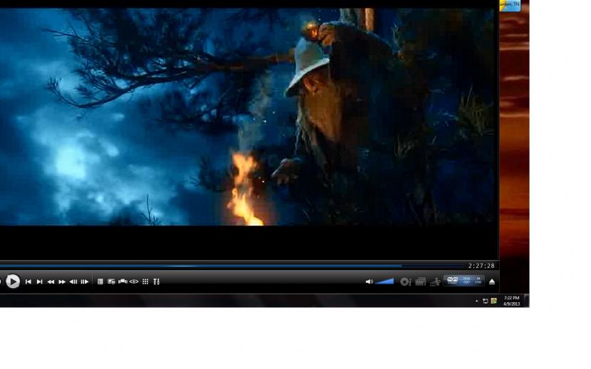

          I slowed down burning speed and still have choppy picture I paused the movie playback and did a print screen so I can attach it here. My computer burns at 20x speed I slowed it down to 8x and still no luck getting a good copy.
