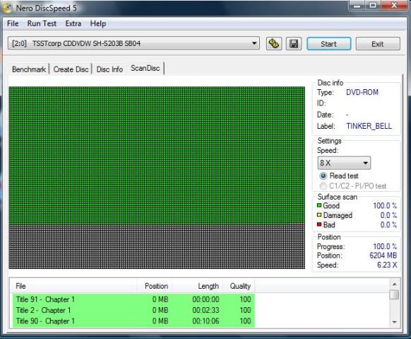

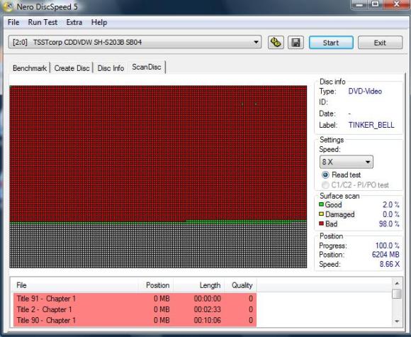

              I remembered having a really bad one, eat up with read errors. It was Tinkerbell the Disney flick. I'll attach a scan without a decrypter running and one with and you can see the pointless nature of scanning this kind of disk.

                    I can test my tinkerbell as well using Nero disk speed on my XP computer and post images also to see if that what is happening as I know my tinkerbells are good DVDs. Which tinkerbell was it the first or second
                      My test was on the first Tinkerbell. I'm looking forward to your results. The tinkerbell in my test is good as well, I made a backup after this test just to satisfy myself. Mine is R1 bar code 8693626548.
                        Ok mine has the same bar code as yours and will give it a try soon using my other computer as it has Nero on it still. I will as well use VSO Inspector on the DVD since this thread is about VSO inspector

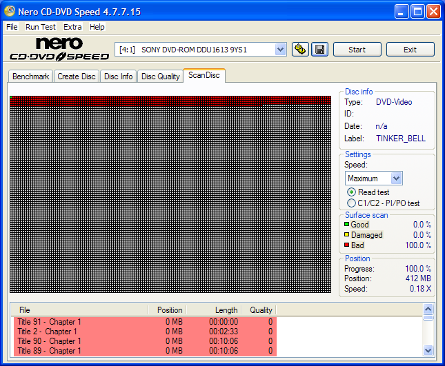

                          here are 2 scans with nero and 2 scans with VSO inspector. The first scan is with a decryptor running and the second is with out a decryptor running. But nero scans suck big time and are not reliable. Now the inspector scans the first is with a decryptor running and the second is with out a decryptor running. On the second scan it only says I have one error and 100% is good so with that result I would have to say my DVD is a good one
