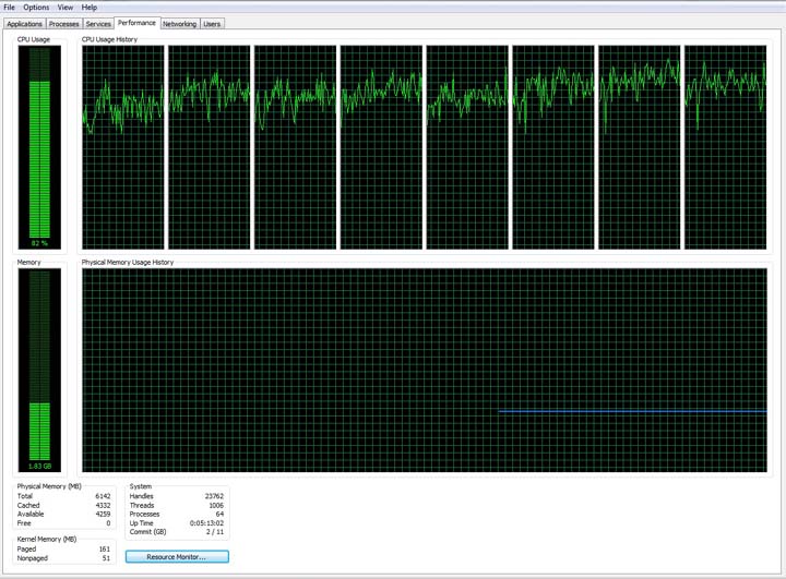

              BTW, I'm using a GeForce GTX 260 card and a core i7 920 cpu @ 2.67 GHz
              I'm at a loss to explain this.
              My speeds are down a bit from 1-2 months ago (I haven't done much with conversions lately), but I'm seeing 300-400 fps. Again, regardless of whether CUDA is enabled or not.
              Heres 'a screenshot of my cpu usage via task manager.
              It's virtually the same for all test runs.

                    Maybe we will get to the bottom of this because everthing I have read about the CUDA processing states that your processor should be freed up to do other tasks and from your screen capture it looks like your CPU's are chugging away on converting and not the CUDA cores..
                      Yup, I suspect this as well and I had been under the impression that cuda was alive and well for DVD to Mobile.
