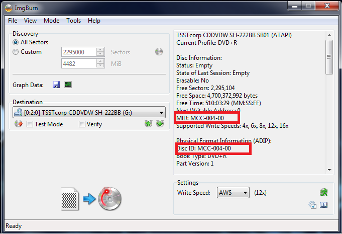

    Never know what they might be? If you have ImgBurn click on discovery and check the MID that will tell you who made them. Verbatim farms out some lower end blanks to other manufacturers.
      This is what you are looking for:

          Verbatim Lifestyle Series Single Layer DVD
          Disc ID: CMC MAG-M01-00
          What is interesting is that other then the name, different id and no AZO on the label, they have the exact same information on the label as the AZO DVDs.

            That is the ID for CMC Magnetics who manufactures blank media for many different brands. They'll probably burn ok but will they last? I learned my lesson by burning some cheap brand discs years ago that wouldn't play after a time. Longevity is the issue with CMC blanks. Stay with Verbatim with AZO or Tayio Yuden.
