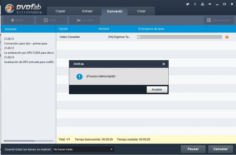

    Hello! i have windows 8.1 64bit, i5 4430, gtx 970, and 344.60 driver's version of nvidia.

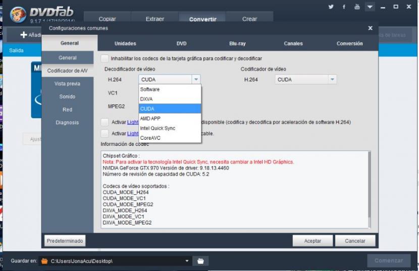

    and if i select cuda in encode and decode, the conversion stop when it start; and if i select lighting-shrink the same problem: the conversion stop when it start

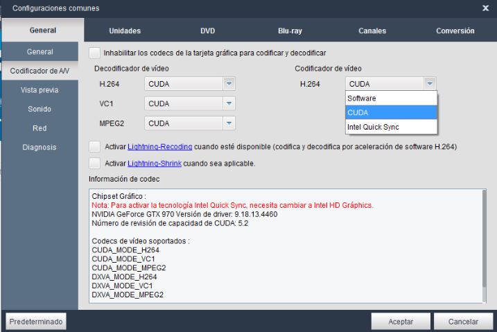

    i don't know how select NVENC for encode and decode

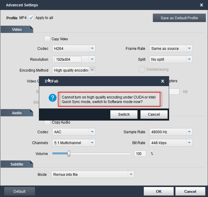

    The issue is caused by the 2-pass conversion.
    CUDA & IQS encode don't support 2-pass encoding method.
    Please switch to 1 pass and try again. And we will improve the logic for the issue in the later version.

      and how i can select NVENC ?
        just need to select "Enable Lightning-Shrink" option in common settings.
        DVDFab will use it automatically when applicable.
