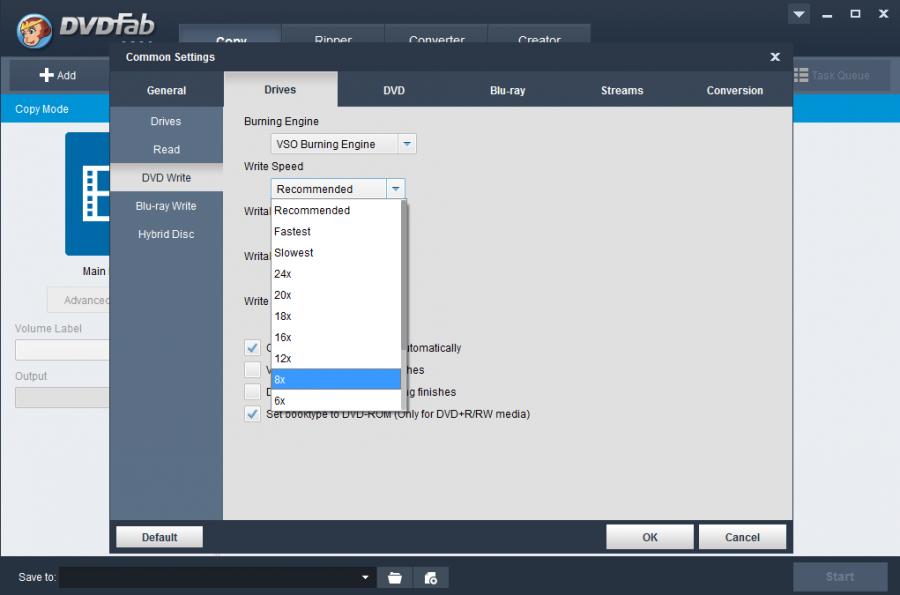

            Your burn log indicates you are requesting 16x write speed "2016-03-03 09:05:02 Info Writing speed requested x16.0, effective x16.0"
            See attachment to set:
            Good job on the logs by the way.
              Also your log indicates that the combination of optical drive and blank media does not support 2.4x burning, 6x is the minimum supported. If using 16x media I would set it to 8x.
                I can now see that it shows I am requesting 16X. I'm not.......but your answer indicating the drive/media combo won't allow 2.4x makes sense. I'll go with the 8x per your advice. Just trying to minimize write errors and generally upgrade write quality. Thanks for your help - couldn't figure this one out for anything.
