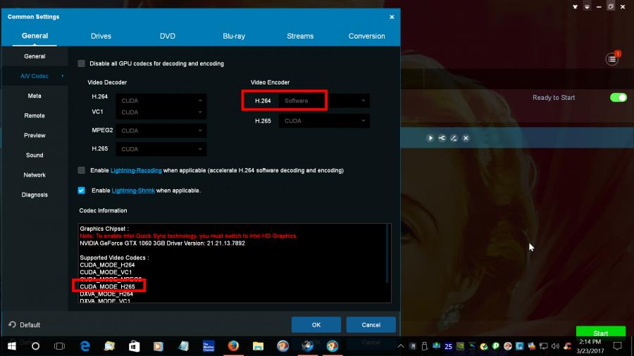

        In my screen shots you will see a pop up come up when second pass is selected in advanced settings it says no Cuda or quick sync help but when selected it turns off h264 Cuda as seen in screenshot #2.Is this a bug or should Fab work this way for 2nd pass conversions? because I can't control how Fab works or why Cuda is turned off in 264 for a 265 conversion in Fabs general settings I have to ask my mentor and teacher of all things Fab Mr Wilson Wang or Fab developer can you please respond to this please I pass the other Banana to you to get the answer.

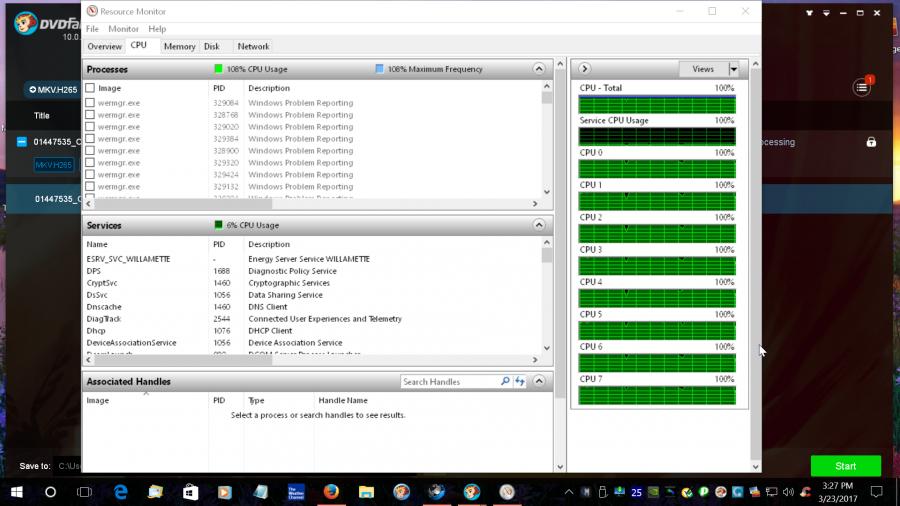

        Screenshot 3 shows 8 processors at 100 percent no cuda help 1st pass

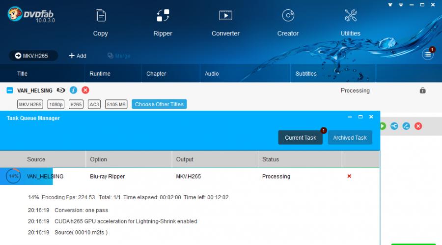

              Huskey Pete:Lets do a test to see if both cards work with cuda.load a movie in Fab set bits/pixel to .40 as you always do and set all the same except do a one pass so set up in settings fast encoding see my screen shot.Now if your cards do work together with cuda Fabs running log should say cuda with lightning shrink being used I get about 222 FPS with one 1060 cuda card yours should be much higher as you have 2 cards and your I-7 chip is also faster than mine so let us know your FPS now so we know if both cards are working together.

                    Wilson what about post #33 why are all 8 of my CPU's running at 100% in first pass with one Cuda 1060 card and why doe's Fab turn Cuda off in fab settings for 264 when doing a 265 conversion with 2 pass after the pop up comes up saying there's no Cuda help or quick sync help and asks you to change to all software? look at the screen shots.

                        Pete: Please do the test in post #36 with one cuda card and report FPS after 2 mins. running a conversion should be more than 222 but just do a 1 pass to see if Cuda works at all for you.

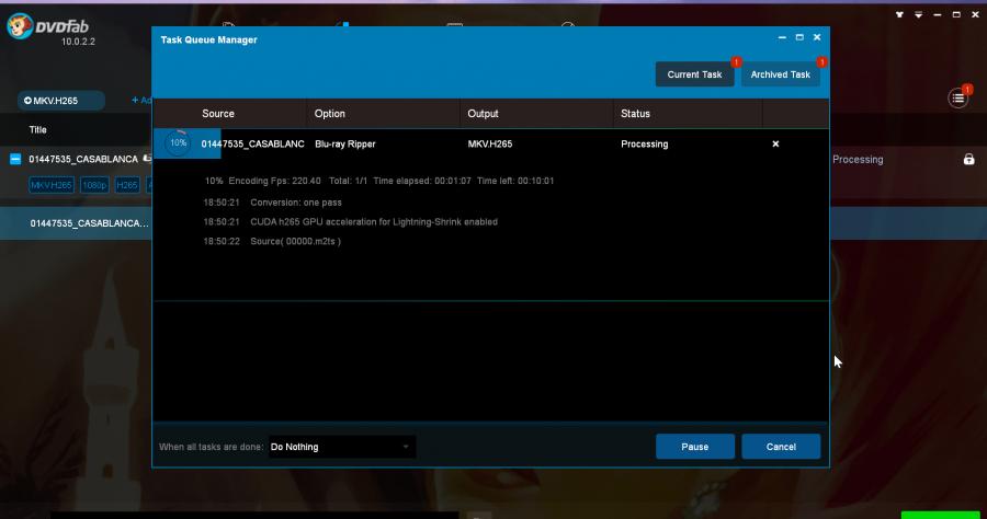

                          Just for reference this is my 980 @ 2 minutes.

                                Check mark lightning shrink and all Cuda for all conversions and please do a one pass to see if your Cuda is working with lightning shrink if you do what I say you may get some results otherwise I am wasting my time here.The running log during the conversion should say both are running and frame count after 2 mins. should be above 222 with one card only please.You need not do a whole conversion cancel after 2 mins. this is a test.
