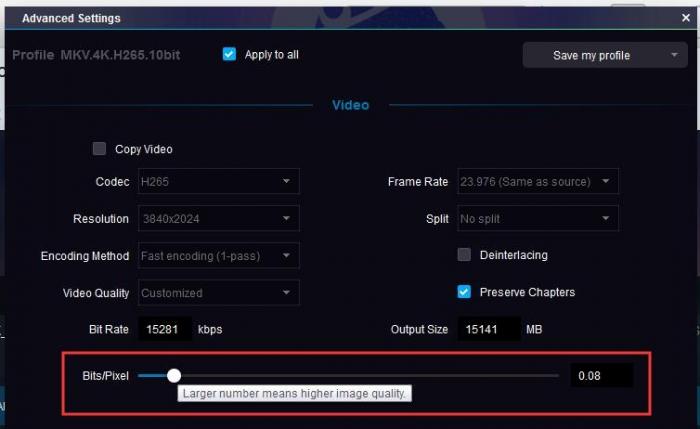

    Started ripping my 4k collection to put onto a 4tb hard drive using dvdfab.
    I'm converting to HEVC MKV 4k 10 bit but I'm not sure what size I should be aiming for.
    i'm not too fussed about the sound , because I tend to watch most of them with my headphones on anyway.
    I'm watching them on a 65" OLED.
    I've started aiming for around 15gb which means once the files complete its going to be around 19-20gb
    And the quality is spot on, so much so i'm thinking could I squeeze it down a bit more
    I know it may depend on the length of the movie, has anyone got any size guides?
    Click image for larger version  Name:	quality.jpg Views:	1 Size:	29.9 KB ID:	375397
    Hi, you can move the slider to change the output file size, set the value between 0.1~0.15 and it should be able to output a file in a smaller size with ok quality.
