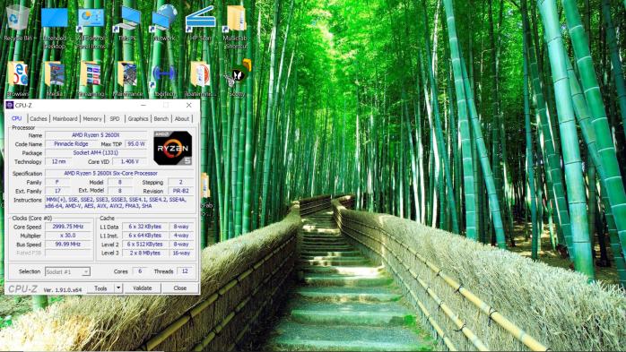

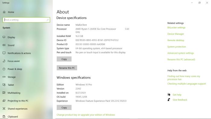

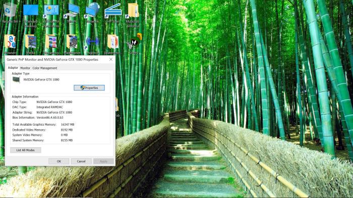

    Also, can you provide us with the model of your computer so that we can pinpoint the problem?​
      Click image for larger version  Name:	Compiter Specs.jpg Views:	0 Size:	25.9 KB ID:	428086 Click image for larger version  Name:	Untitled.pngGraphics Card.jpg Views:	0 Size:	80.1 KB ID:	428087

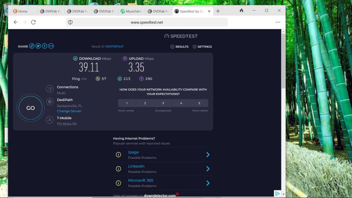

      #Sylvia, No problem. The computer is a custom build. (it was pretty spiffy a couple of years ago. ) Here are the specs. I have uploaded my .log file through the link that you thoughtfully provided. Thank you. Let me know if you need anything else, or find a problem on my end.​ (Internet info below. I don't know if it's relevant.)
