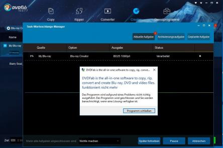

    With the new versions of Dvdfab (x86 10.0.7.7 and x64 10.0.7.6) the Blu-ray creator always crashes with starting to process the task.
Name:	DVDFab Crash.JPG
    There is no problem with the versions x86 10.0.7.2 and x64 10.0.6.6
    This one are workling fine.
    I'm using the latest Nvidia graphic driver and the latest windows 10 updates are installed.
    I did no major change in programms, hardware or something else.
    Please give me a hint, what to do...
    Thank you so much.
    Robert

    Hello Robert,
    Please post the dvdfab_internal.log file.
    Regards,
    mona
      Hello Mona,
      thank you for your answer. Here is the Log-File.
      Best regards
      Robert
        Hello Robert,
        Please click the Menu button (the down triangle) in the upper right corner of DVDFab, click on Common Settings>General>A/V Codec, tick the "Disable all GPU codecs for decoding and encoding" box and uncheck the option "Enable Lightning-Recoding when applicable (accelerate H.264 software decoding and encoding)" to copy/convert again and see if it will make a difference.
        Regards,
        mona
          Hello Mona,
          thank you.
          Yes, this makes the difference. With disabeling der GPU codecs, there is no error, but the speed of processing the rendering task is not acceptable.
          It is even not to understand, why the GPU codecs work in version 10.0.7.2 perfect and why they do not work in version 10.0.7.8. I can't understand that.
          Best regards
          Robert

            Hello Robert,
            Please install the x64 version of DVDFab 10.0.7.7 to convert the video again. Also, please try to convert other video files and see if it will make a difference.
            If this problem happens to a certain video only, please send us the problematic video so that we can test on our side.
            Thank you.
            Regards,
            mona
              Hello Mona.
              I've also tried the x64 version. Last working version is 10.0.6.6. Newer version will crash.
              I've tried different video files, always the same. It is not a certain video.
              Regards
              Robert
                Still not working. Version 10.0.8.0 crashes too. Using latest nvidia-driver.
                I am very angry about that...
                Maybe someone can help me...???
                Thank you.
                  Thank you.
                  Sorry about it, please give the latest DVDFab 10.0.8.1 version a try.
                  Please feedback with the latest dvdfab_internal.log file and fabcheck_internal.log file.
                  Regards,
                  mona
