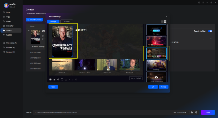

    13.0.1.3 successfully resolved a long standing issue of being able to fully remove the text from (all) boxes in the 'streaming' menu. But now when trying to customize the thumbnail in the main vertical tab (adding a bespoke image), this is now no longer possible as for some reason(?) an image is automatically embedded (see highlighted image below) with absolutely no reference to the added source material -and you cannot remove it by adding your own (previous versions allowed this). I deliberately rename the source material to prevent Creator from adding its own metadata, but since 13.0.1.3 this no longer appears to prevent this embedding.
    I use the streaming menu (highlighted) which is my main preference.
    Click image for larger version  Name:	1.png Views:	0 Size:	135.0 KB ID:	438980
    I wish to add the below highlighted image, but this process no longer succeeds since the 'fix' of being able to remove all text.
    It goes through the process, but the selected image does not appear -and it IS the correct image format being used.

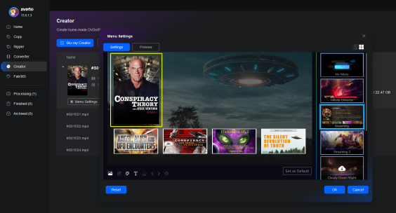

    Click image for larger version  Name:	2.png Views:	0 Size:	147.2 KB ID:	438981
    The ability to customize the smaller title thumbnails with bespoke images DOES WORK as with previous versions. Again, the image format is the same as that trying (and failing) to be added to the larger tab window.
    Click image for larger version  Name:	3.png Views:	0 Size:	125.2 KB ID:	438984
