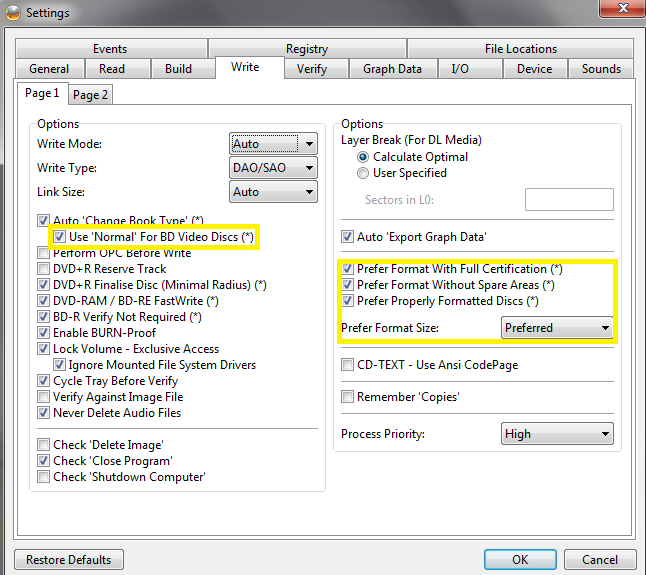

  • W&B
    replied
    Originally posted by DiabloZoe View Post
    On another note where in ImgBurn can you change how its formatted? Ive looked all over!!!
    Click the tools tab/settings/write 1st page. This is how mine is setup and never a problem and the book type setting was added because it was causing problems with some LG drives flaky firmware so if you have change book type settings ticked to begin with also tick the other then right click your drive in the dropdown with media inserted and erase full (pic attached).

  • DiabloZoe
    replied
    Originally posted by crackinhedz View Post
    Diablozoe had this exact same issue when trying to burn BD-RE...you guys should ask him how he finally made it work.
    It has to do with the way the disc is formatted...enable or disable "sparse areas", some devices play back correctly depending on which format method is used.
    Unfortunately that is a snag with BD-RE disc....BD-R needs no formatting and works 100% every time.
    Ihave not tried the movie that I burned on using windows to format the disc, its tricky I have burned a movie but a blank into the drive had ImgBurn format it then burned and it did not play, then did it again and it played!! But what I can say is every movie I have burned (with the exception of the new one because I have not tried it, and its got cinivia protection) all work on PS3 and my samsung bdp 3600-4600!
