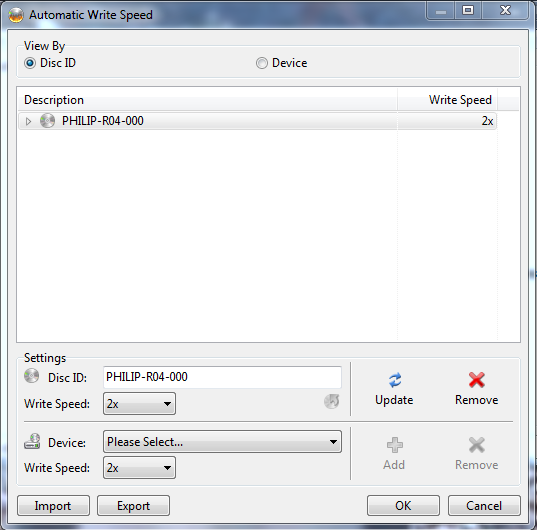

    Hey I am posting again to get some help setting the burning speeds again! Since the 2 new updates ImgBurn and Fab disks are writting at the max speed! Aws has been set as there in no change in the media! And Fab is set to recomended speed, When I posted last about this problem setting Fab to recomended was the fix but its set up like that. I am posting the most recent burn log!

      The only logs I have are ImgBurn log, which just has information on a BD9 disc I tried to burn and VSOburning log. But here are the screen shots

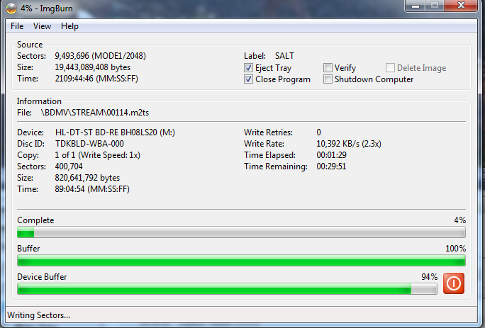

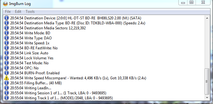

            Here are the new pics and even got a wrong burning speed error

                The lowest possible speed with that media is 2.4x speed. So when you select 1x, it will go for 2.4x. So there is no issue to fix.

                    Nothing worng here with DVDFab or ImgBurn and the write speed as you can not get a burn speed lower than the minimum rated speed which these blank are 2.4x and you wanted 1x. Sorry but that will never happen with any burn progam around
