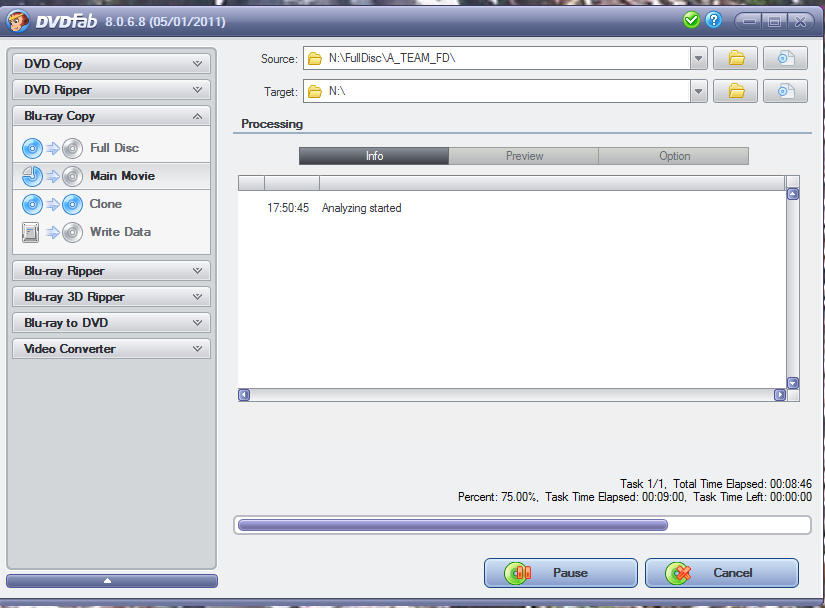

    Testing the new cinivia work around and during the burn process the task time left is 00.00.00 but the %complete is still progressing.
    A minor flaw so far. If the copy doesn't work I'll post back later.
    See another minor bug there.
    When path contains & it takes it as underline for next character.
        i got something like that in ver 68 could be a bug from there
        Please use attachment button and attach your most recent, Internal and Burn log(s)and post right here.
          Hi DiabloZoe
          That is a analyzing process,not begin ripping,so i think that's not a bug.
          Joe
