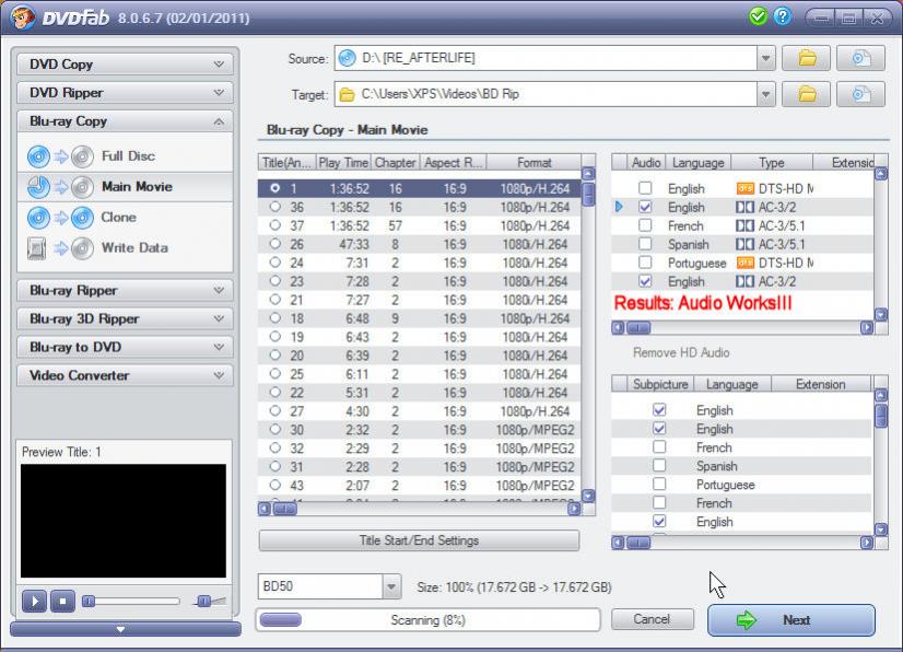

          I run into this where the DVS (Descriptive Video Service) track is included when trying to copy the Main Movie...
          I have had succes using these settings, image follows.
          Although since the update to 8.0.8.5 simply using the DTS HD Master seems to work OK...
