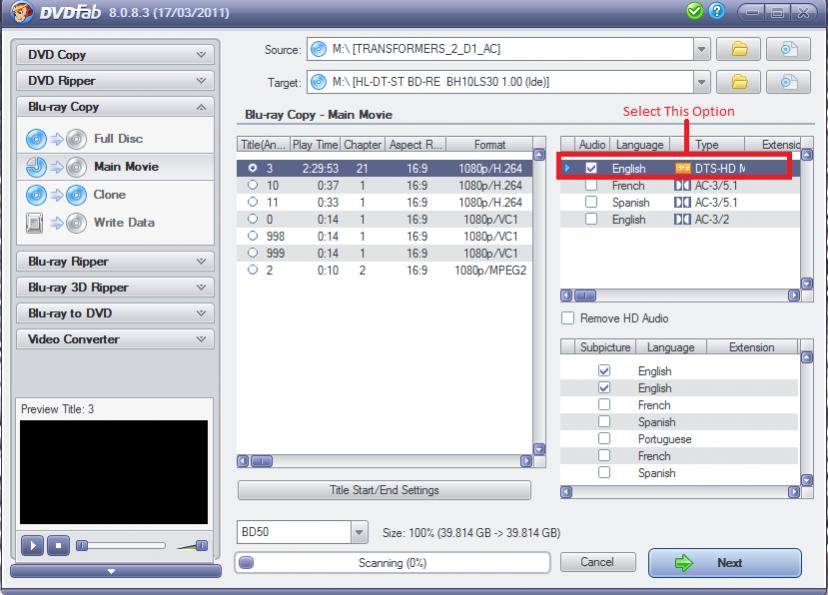

          Please refer to the included picture for what you should select for this move and future BD's that you would like to back up! If you have anymore question please feel free to ask!

                  CBR929 and Diablo Zoe are absolutely correct. But for further clarification, I'll add a screenshot from Transformers so it will be clear to you.
                  When I played the preview, after unchecking the last English audio selection on the right side of the screen, it did play the director's commentary because that's what that selection is. And as CBR929 said, it remembers only that last audio selection. That's why he recommended right-clicking on the actual preview screen and selecting the correct Dolby TrueHD audio track from there, and it worked.
