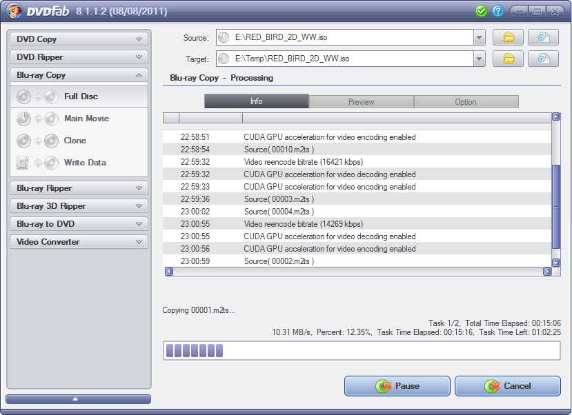

      JustLooking, just tried encoding LOTR ROTK from 50 to 25 directly from disc to harddrive using CUDA only. GPU usage was @ 98%.
      It averaged out to 10.0 MB per sec with a process time of 57 min. This is due to the fact that I am running a GTX 580 and my blu-ray burner is 12x and yours is 10x, so my faster read speeds are helping alot.

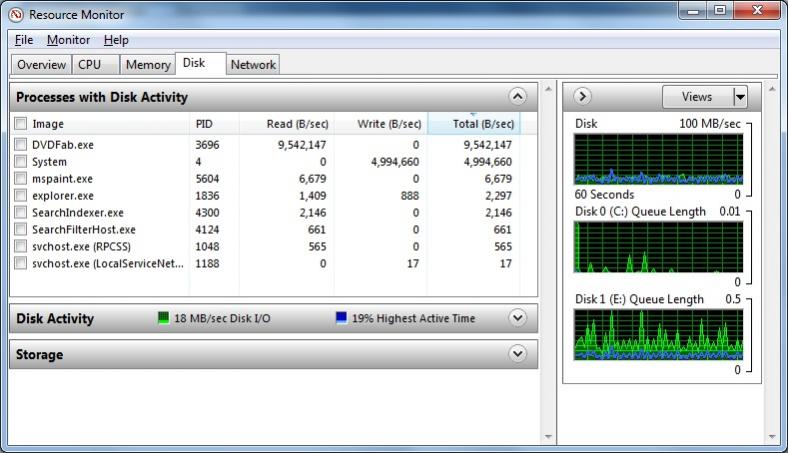

        If you're pulling from Bluray directly, then I'm thinking your faster as I'm first imaging the Bluray to HardDrive first, and then processing it off the hard drive (found running off the Bluray too slow, as I've run like 20 re-encoding trying different things.. I like to tinker)
        My break out is as followed:
        40 minutes to read BD50 to iso to hard drive (one time)
        5-10 minutes (check of image. 100% disk, very little cpu)
        70 minutes to down sample to BD25
        2 minutes to generate BD25 ISO

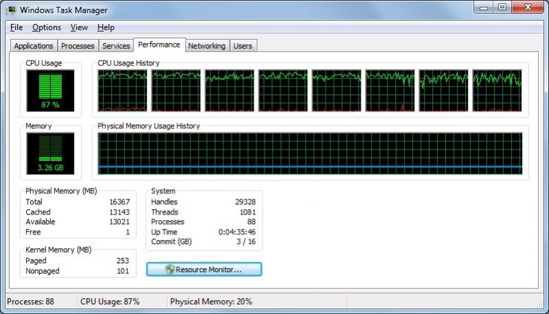

        What CPU usage is shown during the re-encoding? I'm running about 70-80% CPU.

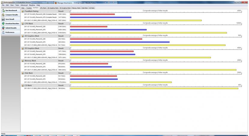

        Aside: If you ever use passmark.com to benchmark your machine? If so, I've attached my PT file for this machine, which can be used to get an idea on where the 2 machines differences (if interested). Also included a JPG of the difference between my i7 and AMD X4 (CPU upgraded from a X2)

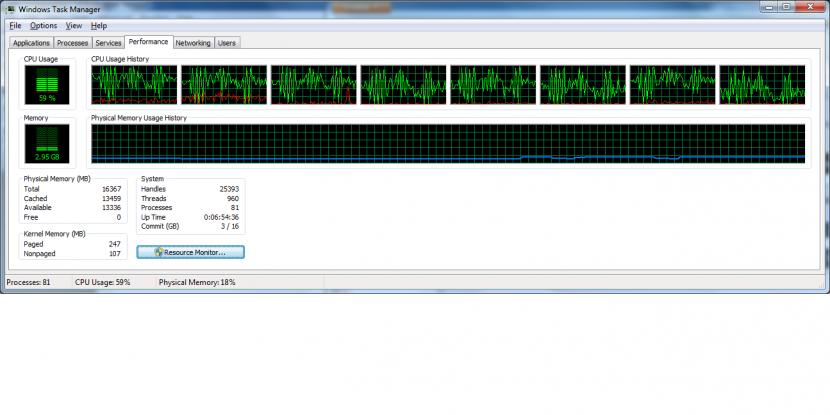

          When I have both software and cuda selected, I am at about 50-60% cpu usage across 12 cores.

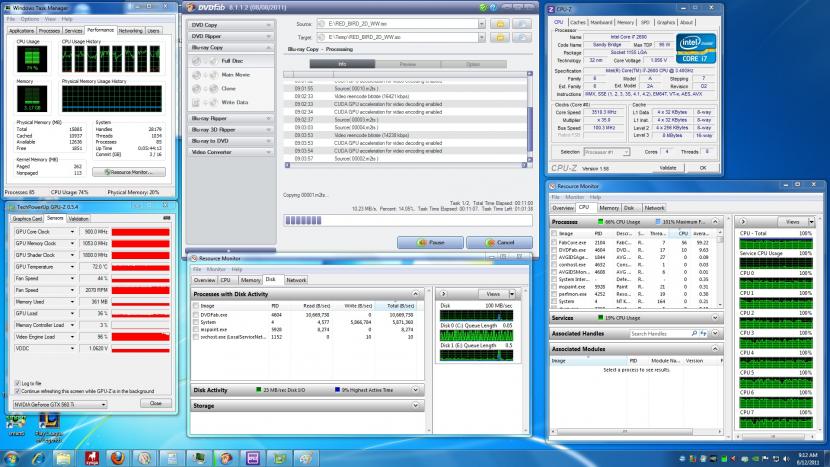

              Find attached, a jpg of an encode in progress with perfmon, cpu-z, gpu-z stats
              I am using the latest version of GPU-Z
              Running 99% most of the time. Thanks for the info on this tool :-)
              I'll have to try the iso thingy to see how it compares
              Think it'll be another nail in my systems coffin... Expect you'll drop another 5-10 minutes ;-)
              Aside: the more I think on this "iso thingy" :-) , your current Direct From Bluray Reader method seems more logical/easier , as you can start it up, and come back with it all done... Might have some extra wear/tear on the reader; but less baby sitting. Getting everything quickly is only really relevant if your sitting waiting for it to finish.
              Anyhow, I've come to the sad realization, that this system I put together is faster than the previous; but not nearly as fast as I was expected and truly gets smoked by faster machines (some are 4x what mine rates at)
              As per your system, the overall Video card benchmark posted on passmark is at least 25% faster than mine
              Since the CPU isn't maxing out on yours or my machines, most likely the Nvida Video Card is the bottle neck where you're 25% works out to somewhere around our difference in times. Looks like I'll be looking into a upcoming GForce 6
              Hopefully the Sandybridge Quick Sync ain't just hype, and when i can get it working with DVDFab, will get some improvement over CUDA. I really wanted to beat my chest on the awesomeness of this machine.. lol

                  Originally posted by ernielee View Post
                  Try Decode all to software and Encode Cuda+Software on your A/V setting
                  Not good.. CPU at 100% ,GPU 24%. Well over 3 hours.. Didn't finish it.
                  Oh well... worth a try
                  Wal
                    Wal
                      - Enable Full Scan
                      - EncodingSettings: SlowSpees/HighQuailty
                      Change EncodingSetting:FastSpeed/NormalQuality
                      A little faster.. Didn't run in the whole way through. Based on what I've seen, a little over 60 minutes would of been the overall time
                      was getting about 10.8MB/s when I stopped the test (Kids wanted to use the machine for LOL)
                      GPU about the same, CPU a lot more erratic (30-80%)
                      Looks like the bottle neck is the GPU :-(

                        10.8MB/s that very good.
                        I do movie only decode software encode software+cuda and
                        avg is 12.5MB/s @40min avg time, CPU 95% GPU 60% avg.Some movies are faster.

                          Only been doing the full Disk
                          Look like your bottle neck is most likely CPU based.
                          I've been doing some more digging in the forums and seeing some opinions that CUDA helps in throughput; but lacks in overall quality
                          It might of been wiser for me to spend a bit more, and get the fastest CPU, verses spending an extra 100 dollars on a video card... Who really needs 130+ FPS in games when 60 would do :-)
                          I'm just running another test with Software Decoding and Software + Lightning encoding, getting about 9.6MB/s at around 90 minutes expected finish time
                          The strange thing is, that my CPU is between 80% and 95% usage. Would of expected closer to 100% usuage
                          Very true. Depends on how much work is involved to decode/encode based on amount of video data, and how much motion is occurring.
                          For us to have a more accurate representation of the differences, we'd have to be using the same source.
