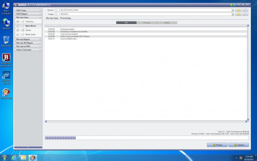

            Problem with Main Movie Copy...
            Here is my latest attempt...
            As you can see in the screenshot, the time elapsed
            is over 6 hours....
              Takes Forever

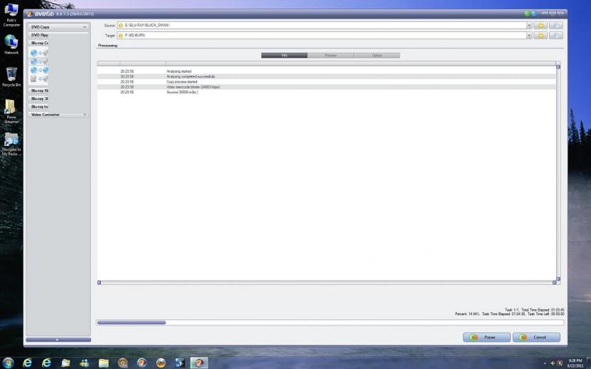

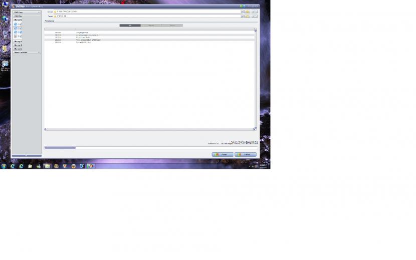

                          After re-installing both v8.1.1.2Qt and v8.0.7.3, I am still running into the problem of DVDFab just stopping about 1/4 to 1/3 way into a compression to a main-movie backup of a Blu-ray, even using v8.0.7.3. Here are 2 screenshots:
                          I will also post the log from an attempted backup.
