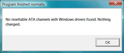

  • maineman
    replied
    Sorry, I've been away for 3 days.
    I see from post #18 that you're running Vista and and this:
    Intel(R) ICH9M-E/M SATA AHCI Controller
    Bummer, I'm afraid all bets are off...including the .vbs script registry patch.
    I'm not familiar with this controller and I have totally avoided Vista, but to the best of my knowledge, DMA is not applicable with your setup.
    I also avoided the AHCI drivers and went with IDE when I built my Win7 rig 2 years ago.
    There's a very slim chance that enabling an IDE configuration in your bios will help with this issue, but frankly, I doubt it.
    Nothing I've read seems helpful.
    I have no idea what changed with Fab to create this issue for you.
    I'm assuming this all went bad with the QT versions?
    A few thoughts:
    Taking 48+ hours to rip a BD disc is beyond absurd.
    Couple this with the fact that you're using a laptop with an internal slimline ODD and you're really at a serious disadvantage.
    Please don't take this personally, it is not meant to criticize you.
    Slimline burners are less than ideal for BD processing, plus they are subject to excessive heat.
    Add this to your 48+ hours of wear and tear and I'm surprised it works at all.
    Also, the burner is very likely a Matshita or as Fengtao says, matSHITa
    You may get around all this by using an external ODD, particularly for ripping, as this seems to be your biggest problem.
    Do you have an extra BD-ROM or RW or can you borrow one?
    I'd hate to recommend buying one since there's no guarantee it'll resolve the problem...but it should.
    You would get the ODD off the current controller and onto the usb controller,
    plus you'd have a more robust burner and not exposed to so much heat.
    You can thow it in an external case or just jury-rig it and connect via usb.
    While a desktop is better suited, there's no reason you can't use a laptop, plenty of Fab users do.
    Sorry I can't be of more help.
    Leave a comment:
  • DVDFabLover2011
    replied
    I just ran the "resetdma.vbs" script. Here is the result. Please see screenshot.
    Leave a comment:

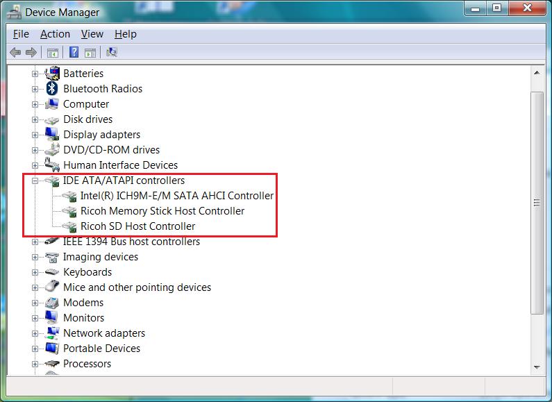

  • DVDFabLover2011
    replied
    Originally posted by IPopov50 View Post
    You are almost there:
    right-click on controller (inside red square on your screenshot, Intel) -> Properties -> Advance Settings.
    Post here what you see
    Dear Mr. IPopov50,
    Please see my post # 18 in page 2.
    Thank you.
    Leave a comment:
  • IPopov50
    replied
    Leave a comment:
  • DVDFabLover2011
    replied
    Hi DVDFabLover2011
    Go to Device Manager, click on the IDE ATA/ATAPI Controller, double click the first IDE Channel, click Advanced Settings this will show you your DMA status.
    CBR929
    CBR929,
    I don't see it. Please see screenshot. Thanks.
    Leave a comment:
