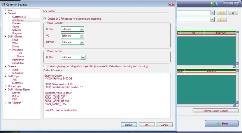

                  Hi Booger007
                  Turn off Cuda and set everything to software.
                  See pic
                    CBR929, as I said in my original post, software works but is painfully slow. I want to make sure DVDFab is aware of the Cuda Problem.
                    And it is not my PC, Core I7 3930K, 16 Gigs Ram, Samsung 830 256GB SSD
