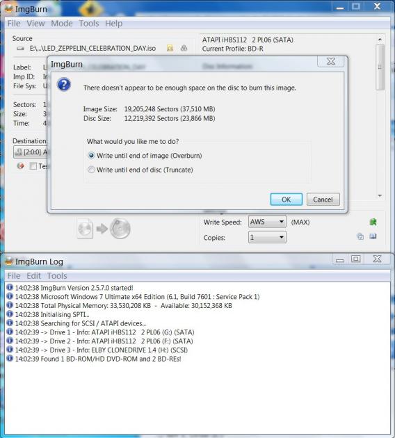

    So tried to take the new larger 36.6GB iso to a Full Disc BD25 using 9.0.3.0 and it goes right to burning the disc but is now showing in ImgBurn as 19,205,248 sectors (37,510MB) Screen Shot from ImgBurn below
