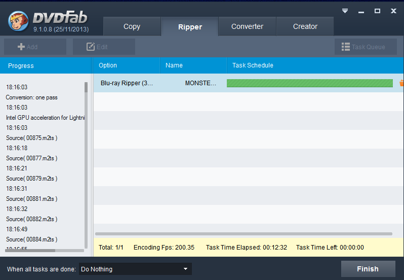

                            mainman you have an i7 processor, have you tried Intel Quick Sync?
