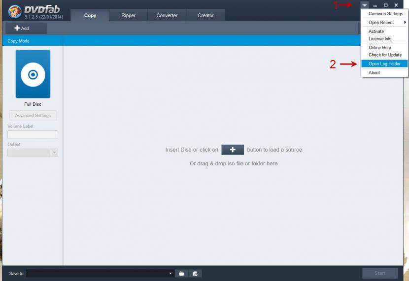

    Please post your internal log so that someone might be able to help.

        You can use copy and paste in notepad to select the relevant part, save to a folder then use the attachment button that looks like a paper clip to browse to the folder then upload it here.
        Be sure to send your internal and burn log.

                          Please post your dvdfab internal log file here, may be useful for us. thanks.
