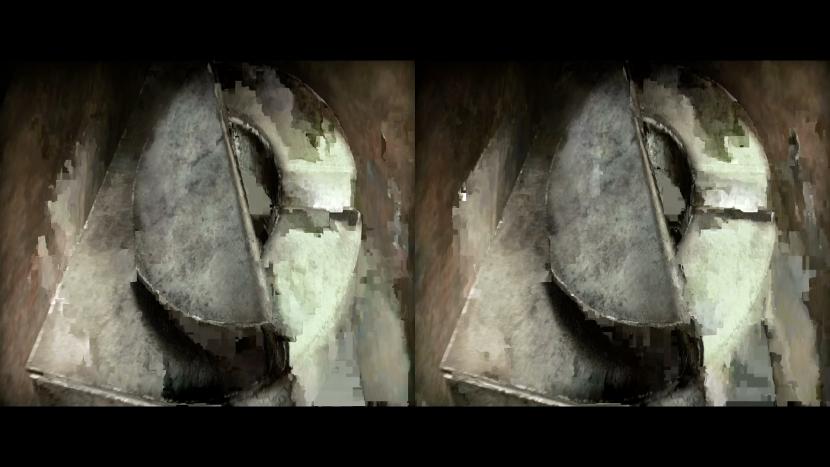

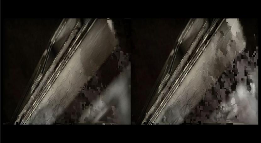

                          Got it working. I've attached 2 screenshots displaying whats occurring. Thanks
                          I've also tried Media Player Classic - Home Cinema. And the iso's with tearing do not work with makemkv. Those without tearing work fine with it.

                              These particular images in my previous post were with media player classic, but they display the issue with all media players. Yes, they are playing on my PC, not streamed at all. I haven't tried steaming them since they don't work on my PC. Both VLC and Fab media player also have the issue.

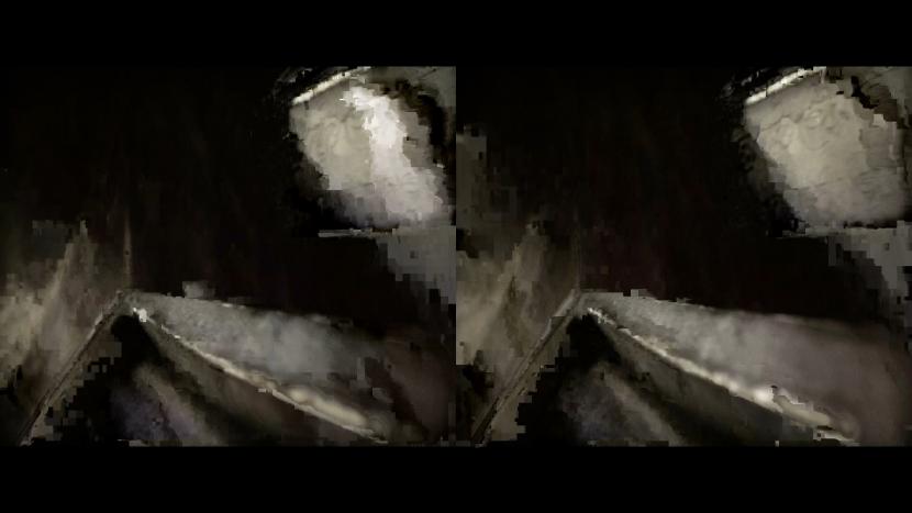

                              An image fom VLC is below. I'm using powerdvd 14.
