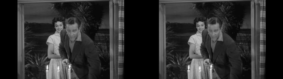

                    Full 3D ICFOS
                    Hi Guys
                    Yip... Yip... Yahoo!
                    Got v2505 and SBS works from Full 3D iso!
                    I took a Snapshot of ICFOS to show you what I am
                    talking about the center of SBS being a wide black
                    column. The 2 halves should butt together in the
                    Center to play in 3D on a 3DTV properly. I had never
                    seen this happen before but I did burn to 25gb BD and
                    it plays perfect 3D on 3D BD player.
                    Now is someone can fix X-Men Apocalypse 3D US
                    Thanks Guys So Much
                    JohnnyJT
                      Looks like the black spaces of the 4:3 aspect ratio doubling in the center.
                        Those thick bars are normal for 4x3 content.
                        So no one gets confused you can make a 3d side by side from a 3d iso or store brought disk but you CAN"T play a FULL 3d iso or full 3d store brought disk in side by side with any media player you must convert the disk or iso from full 3d to side by side first then it will play in most players.
                        When you convert full 3d to Side by side 3d they become data files not blu rays any more that's why you can put them on dvd's or blu rays your 3d tv puts the 2 side by side pictures into one 3d picture so you don't even need a 3d blu ray player as most 2d players will play data files but you need a 3d tv to play the side by sides.
