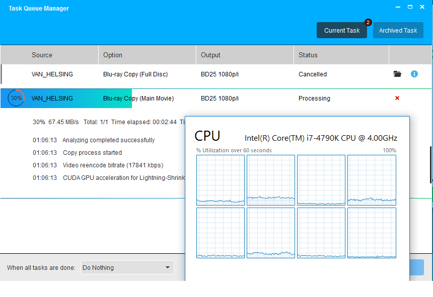

On this disk blu ray full disk and play is supported you did a main movie seems Fab has trouble compressing so try full disk and include the whole log next time that was just the bottom half.
Actually it's the graphics driver, Windows 7 uses 376.54 so I rolled back to 376.33 (close as I could get for W10) and now Fab is up to speed and CPU loafing. See below:
